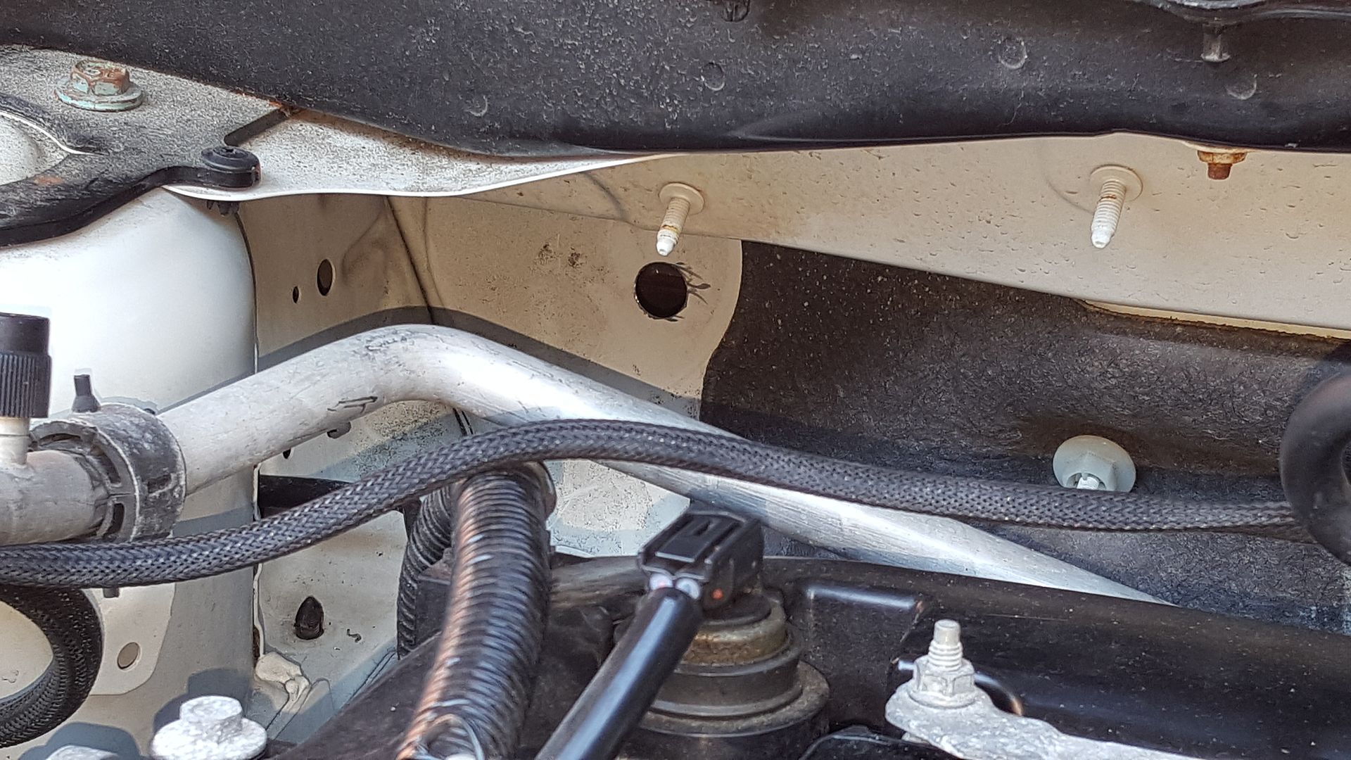

Here's my solution:
On the passenger side of the engine bay youll see a circular outline. There is nothing even close to this location. I ended up drilling through this area (full glove box must be removed) from the cabin into the engine bay. I put in my own grommet and sealed the grommet with RTV.
Heres the pics for future reference:
