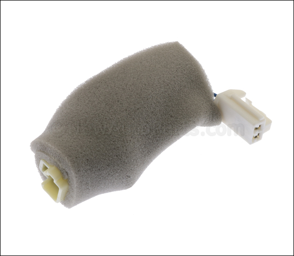

    so this is the resistor you "replaced"?
    It doesn't exist from the factory!

    Quote Originally Posted by TheMAN View Post
    It was the part number you provided for the resistor in a prior note BPY1-61-545A....done by the dealer and listed on the workorder. It was installed along with a new diffuser / cabin filter. I cannot confirm the picture as I did not install it.
