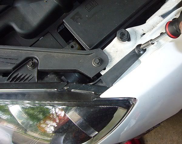

1. Remove the 11 8mm (or phillips) screws on the bottom of the bumper.

5. Pull back the shield alittle and you'll see another 8mm screw by the bumper seam, take it off. (per side)

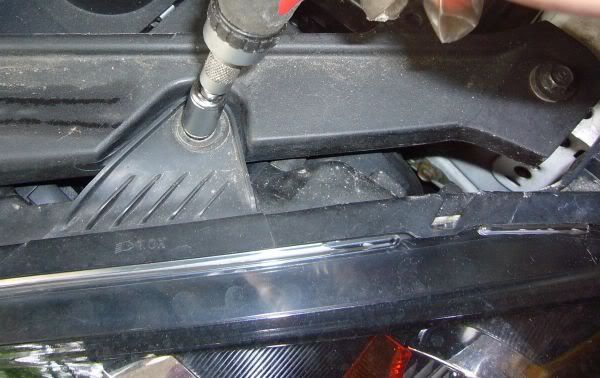

8. There are 3 10mm bolts holding on the headlight. One is ontop quite visible. One right infront (bumper) inside the black thatched part on the bottom of the headlight. Another is off to the side.

9. Pull towards the front (to clear the fender) and unclip the high/low beams and you can either unclip or remove the turn signal assembly (what I did, since its not halogen)

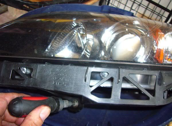

12. On the bottom of the headlight assembly is a large plastic 'frame'. One phillips holds it on, then there are pressure clips on either side.
http://i8.photobucket.com/albums/a6/...HLBremoval.jpg

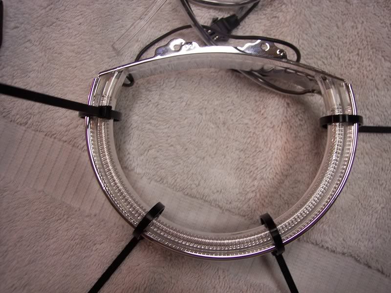

20. Place the rings where you want them. The low beam is pretty obvious, but the high beam will seem it sticks out a little (thats ok). USE SILICONE AND NOT THE TAPE (clear drying kind. I used GE type2). Can't stress this enough, I've read peoples rings coming off cause the tape doesn't hold so save yourself the hassle please. Place a 1/8th inch bead where the ring will touch then use zip ties to hold it securely for about 30min. (silicone is tack-free in 30min, full cure in 24hours)
http://i33.photobucket.com/albums/d8...11/Halos38.jpg

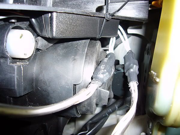

37. Secure the ballasts to the car using zip ties. Then connect the wires from the angel eyes (coming out of the headlights) to the ballasts.
http://i8.photobucket.com/albums/a6/...st-topview.jpg
http://i8.photobucket.com/albums/a6/...insideview.jpg

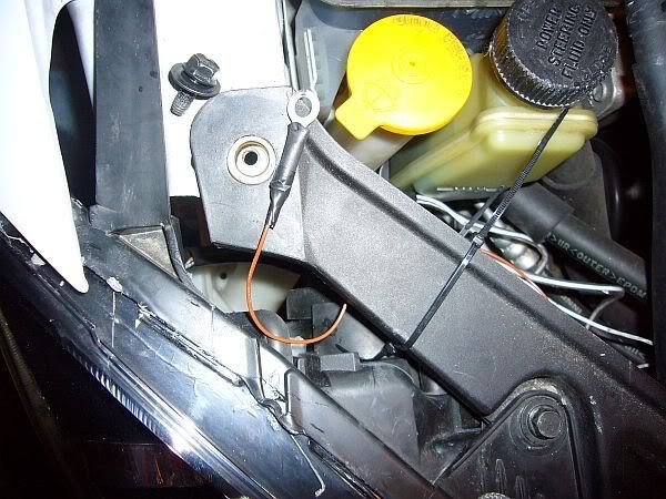

38. Connect the ground to any local frame/metal/something bolt thus it will ground to the chassis/frame. I grounded it to the spot below. Make sure to ground it to a spot which touches a metal part of the car. You simply remove the screw, place the round connector around the screw and then screw it back in. I did this for each ballast.
http://i8.photobucket.com/albums/a6/...undingwire.jpg

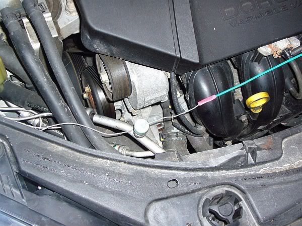

40. Run the power wire to the top left empty fuse holder (when looking from the top, over the driver fender). Because of the size of the connector, you have to use scissors to cut a piece of the metal off so that it would fit properly in the fuse box. Start by cutting off only a small piece and then keep trimming it until it fit perfectly. Here is a picture of the original connector next to the cut one
http://i8.photobucket.com/albums/a6/...onnectorCU.jpg
http://img350.imageshack.us/img350/6...2047Medium.jpg

Well thanks to Gizzmo and many others, I finally got around to this install! I'm not going to do a complete write up since most things are covered in the original post, but I'll add some info and photos on some things, in particular on the wiring, which was the toughest part for me since I am (er was) a wiring newbie!
Perhaps Gizzmo can add some of this to the first post:
Removal of headlights from car after bumper removal:
There is 4 screws to remove.
Screw #1 removed using a screwdriver (screw is held in by a plastic fastener, be careful to keep everything in a safe place where they won't get lost!):
http://i8.photobucket.com/albums/a6/...Lremoval-1.jpg
Screw #2 removed using a socket wrench
http://i8.photobucket.com/albums/a6/...Lremoval-2.jpg

Once you remove the screws you simply pull it off the car. Make sure you remove and 3 light bulbs/wires from the headlight (low beam, high beam and turn signal) before removing the headlight. To remove the bulbs simply twist them and then pull them out.
Once you have the headlight removed you will have to remove the bracket at the bottom before taking apart the housing. There's only one screw holding it in, as shown below:

The first thing I did was to secure the ballasts to the car using zip ties. I then connected the wires from the angel eyes (coming out of the headlights) to the ballasts.
Here is a top view of the ballast secured:
Here is an inside view:
The next step was to ground the (brown) negative wires. I stripped the wire using the wire stripper (but I'm sure you can do it by simply using scicssors). I then attached a circular connector (make sure to get the right size which will fit the width of the screw) and then crimped it on and taped it up with electrical tape. I grounded it to the spot below. Make sure to ground it to a spot which touches a metal part of the car. You simply remove the screw, place the round connector around the screw and then screw it back in. I did this for each ballast.
The next step was to connect the positive wires from each ballast together. I cut one piece of the wire I bought which was long enough to span the entire width of the car from headlight to headlight and also added a bit of length just in case. I stripped all the end of the positive wires and long piece of wire. Then I used a butt end connector to make the connections. Simply insert the exposed wire on each side into the connector and then crimp using the lock wrench. See below for a pic of the positive ballast wire connected to the long wire (green):
http://i8.photobucket.com/albums/a6/...reoverview.jpg
For the right side connection I also had to add another piece of wire which would be used to "power" the angel eyes via the fuse box. So, using a butt end connector once again, I inserted the exposed wire from the green long wire into the left end, but on the right end I inserted both the positive ballast wire and the "power" wire. I then crimped all 3 together, as shown below:
http://i8.photobucket.com/albums/a6/...es/crimpCU.jpg
Here's a wider view of this (with the power wire already inserted in the fuse box):
http://i8.photobucket.com/albums/a6/...nrightside.jpg
The next step would be to add the proper connector to the "power" wire which will then be inserted to the fuse box. Crimp the exposed wire to the connector. Then, because of the size of the connector, I had to use scissors to cut a piece of the metal off so that it would fit properly in the fuse box. I started cutting off only a small piece and then kept trimming it until it fit perfectly. Here is a pic of the original connector next to the cut one:
Then, go ahead and insert the power wire/connector into the following empty slot in the fusebox:
http://i8.photobucket.com/albums/a6/.../fuseboxCU.jpg
